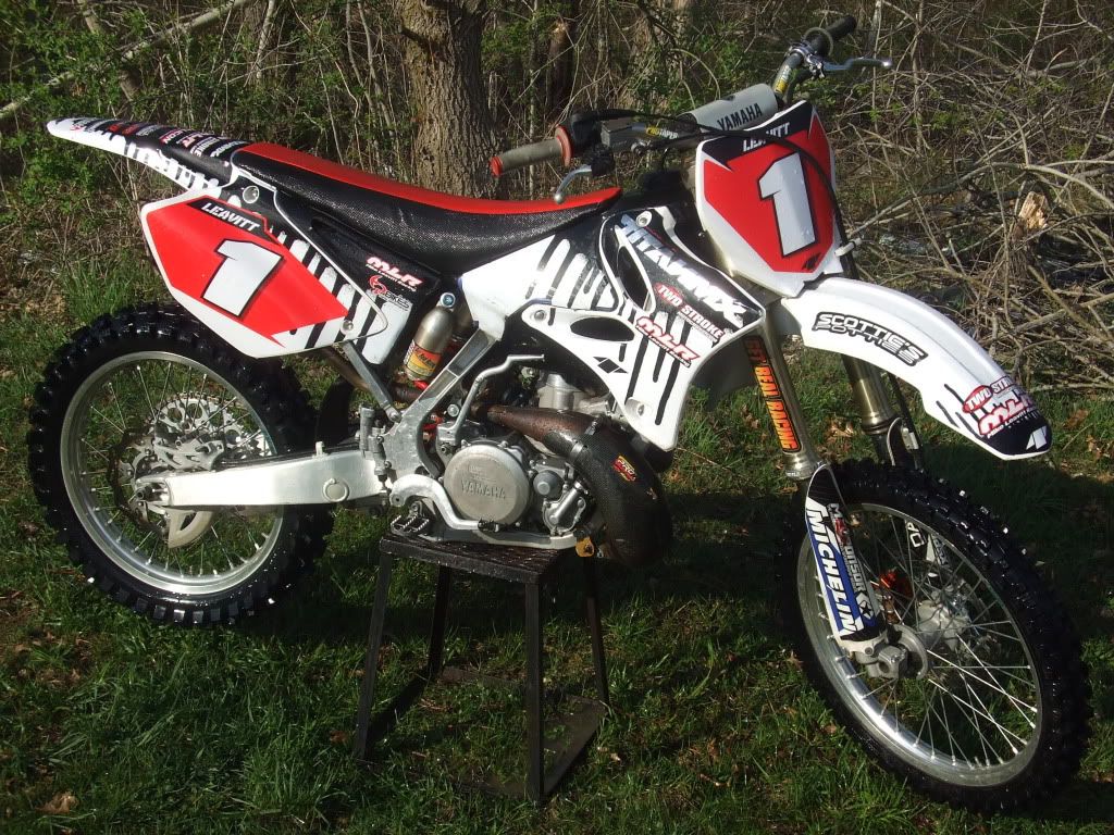

As a guide here is a photo of the bike we'll be using for Project Two 50... it's the bike that Mike raced last year and is now all in pieces.
While not highly modified, the bike has some work done to it. It has a Pro Circuit Pipe/Silencer combo, V-Force Reeds, Phat Head and some mild porting. Of course the suspension has been modded to suit Mike....
