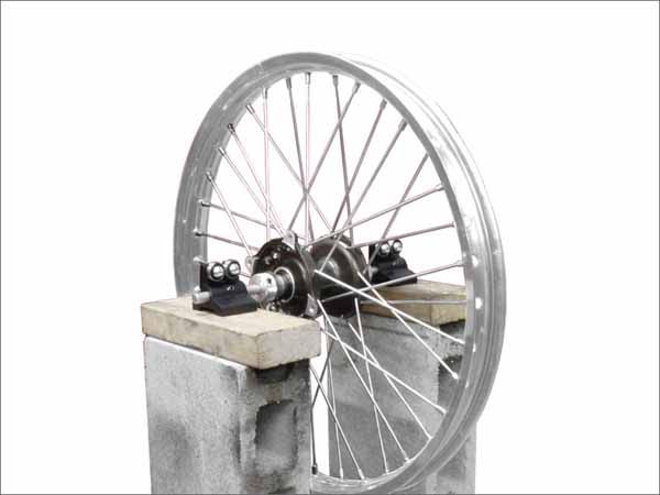

I just did 2 wheel sets for my RM's and it was easier then I thought it would be.
Plenty of videos on u-tube on how to lace and true rims.
I purchased one of these.
Not the bricks. ;D

I like the bricks  :P
If you are going to lace your own wheels, you might think about a truing stand. They are pretty cheap, 120.00 and you can keep your wheels in nice shape. I have a set of Dubya rims on my YZ,  A Dubya front hub on my KTM, They are expensive as crap but bullet proof.

The bricks are from the product cataloge. ;D
I just set it up between 2 bike stands with a carpenters level taped to 1 as my guide.
The easiest way to remove dings or humps is to replace the rims. ;)
