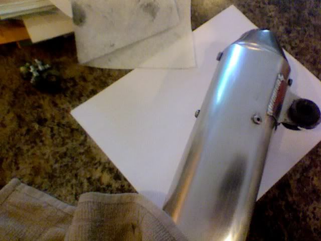

« Reply #14 on: May 15, 2012, 09:45:53 PM »
Couldn't help but post this... I can't wait to slap this baby on
