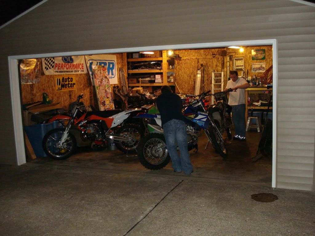

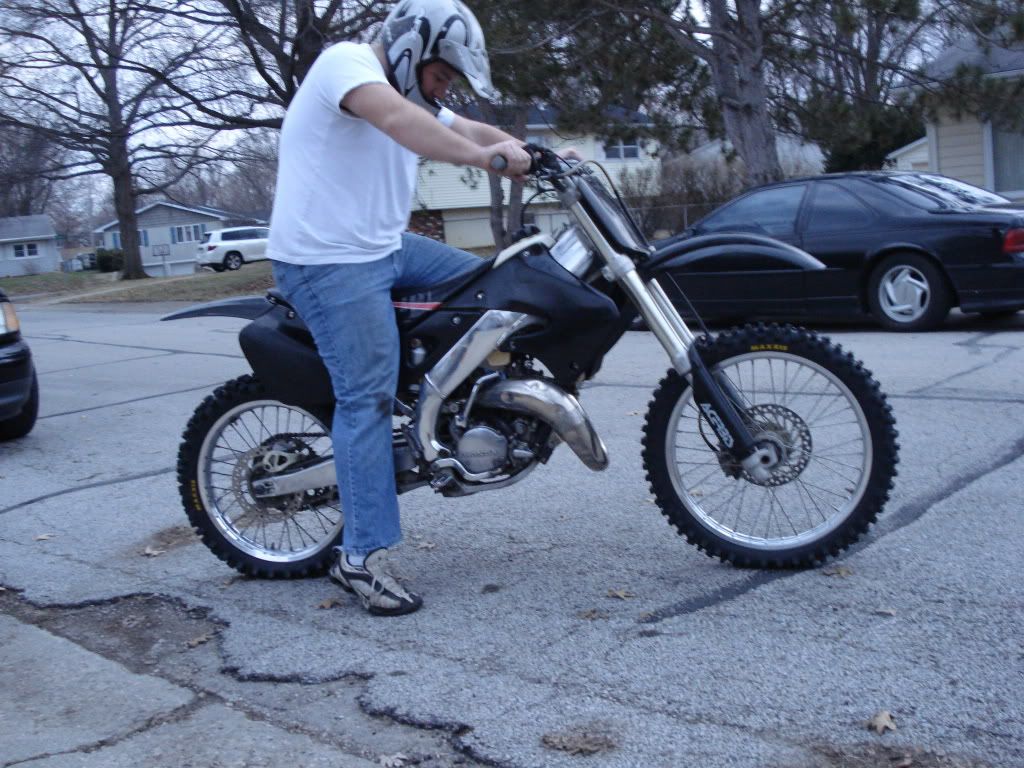

The fruits of our labor.  Pretty much $1050 total investment.  And a happy owner taking it out on the maiden voyage (yes I know the rear tire is low).
And the boys hanging out, talking a little sh*t.
The bike runs great.  It is WAY undergeared with like a 46T sprocket when factory calls for a 53T I think.  That and the jetting is pretty far off (on the fat side).  Fixing those two things should really make it snap to life.  Overall, I kinda like it though.  I had my doubts, but I think it turned out good.

I dig the last pic. I love hanging out in a garage full of bikes, and working/bench racing. Good stuff  :D .

it's a cool picture despite the YZf in the fore ground. ::)
