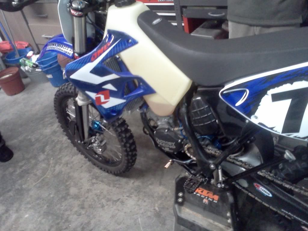

Hey guys, had to share these pics for the fellow woods riders. :)
This is a bike the founder of www.vxcs.org just purchased, I got to go check it out today. :)
Here are the details:
Front:
DNA Racing 21" front wheel, MX51 tire, Moose Heavy duty tube, all mounted at local dealer with professional machine
EBC off road pads
fully rebuilt and cleaned front caliper - Moose Racing rebuild kit
Galfer Stainless Brake Line
Light Speed Carbon Fiber front rotor cover
Speed Bleeder one man brake bleeder
Acerbis front fork protectors
polisport plastics
Tusk front brake rotor
Steering Area:
Tag Metals lower triple clamp and stem
All balls steering stem bearing kit
BRP $619.00 submount setup with BRP upper triple clamp, Scotts Damper, rubber mounted version
Enduro Engineering Handguards w. evolution clamps
Renthal Fatbar: bend: SUZUKI RM / RMZ 06+ ....20mm trimmed off both ends of bar
Fully rebuilt and cleaned Front Brake Master Cylinder - Moose racing rebuild kit
Moose Racing Ultimate Clutch Lever System, matching brake lever
brand new oem throttle housing
roll-on-throttle quick turn throttle tube
Pro taper pillowtop grips
Moose Racing Hour Meter
Moose Racing Fork bleeders in blue
Fresh Fluid and Fork Seals on the forks
Devol Racing Radiator Guards, Custom Rear Brackets
Brand New Oversize Aluminum Radiators filled with Cyclelogic Engine Ice
Silicone Hoses
Outlaw Racing Radiator cap
Middle:
Clarke oversize tank
new yamaha petcock, extra external filter
Moose tank breather on the cap
FMF gnarly pipe
E-line Carbon Fiber Pipe Guard
Max Power fully installed/inspected 167cc Big Bore/Stroker Kit.  i had him inspect every part of the motor/tranny and replace anything needed, final bill $2,281.00
Moose Racing heavy Duty Magnetic Drain Bolt
Boysen Clutch Cover
Boysen Supercooler Kit
Boysen Ignition cover
Boysen Rad Reed Valve System
Sunline Shifter
Renthal front sprocket
RK 520EXW GOLD XW-ring chain 520x114
Fully restored factory Mikuni TMX carb
7602 Racing Carb Breather Kit, one line running up near steering head
Rear Middle:
SDG complete seat
Pro Cicuit oversize Pegs
UFO frame guards in black imported from UK (extra new set included)
airbox from a 1999 since its black
Sealed the lower part of the airbox for water crossing, 3m weatherstrip adhesive used
twin-air airfilter
Billet Twin-Air Filter Bolt
Hyde Racing Skid Plate
TrailTech kickstand
TM designworks Upper and Lower chain Roller
UFO chain slider
BRP chain guide
brand new factory 2005 rear shock with titanium spring
Linkage fully restored with Pivot Works bearings
Rear:
Renthal Black rear sprocket
FMF Q muffler
acerbis rear mudflap
imported Pro Carbon - Carbon Fiber Swingarm Protectors
Fully restored swingarm with Pivot Works Bearings
DNA racing rear 18" rear wheel, blue hub
MX51 rear tire, Moose racing heavy duty tube, mounted at local dealer with professional machine
galfer stainless brake line
Speed Bleeder one man bleed screw
EBC off road pads
Tusk Rear rotor
Fully cleaned and rebuilt rear caliper - Moose Racing rebuild kit
Scotts billet shark fin
Devol Rear Caliper Guard
new factory axle blocks
I'm not a fan of the oversize fuel tank, bit I guess it serves it's purpose. :)
Lot's of attention to detail on this bike. :)

Looks great... Besides that gas tank haha

I don't mind the tank, but they are common on woods bikes so maybe I am just used to seeing them.

that's a real nice scoot, were it me I'd go with white plastic, it will help make the large tank look not so wonky

What year yz is that. I want to say 2000 to 2001 but correct me if im wrong.
Re: Hare Scrambled YZ 167 :)
« Reply #10 on: February 07, 2011, 03:56:44 PM »
I'm pretty sure it's an 01, we are supposed to go riding this week/end. I'll find out.

One bad mama! I wonder how it runs? I've heard good and bad about the 167s.

I've heard about crank issues with the 167 but, I noticed it is a Maxpower stroker. So, that might solve the issue?
