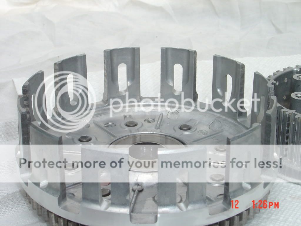

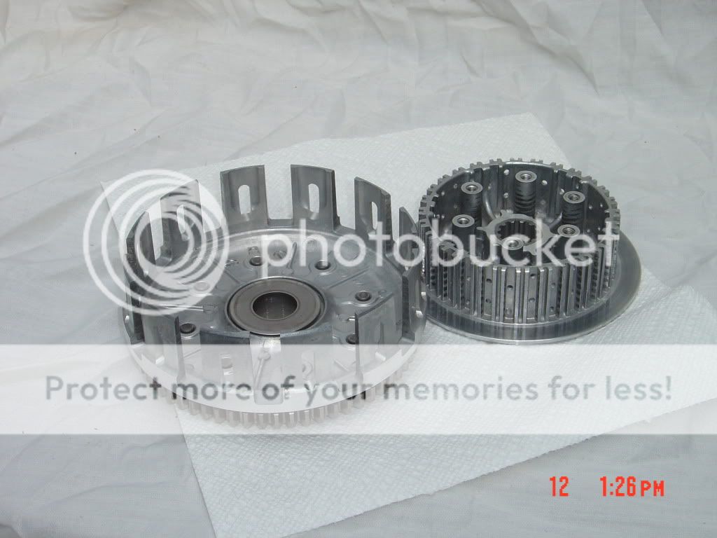

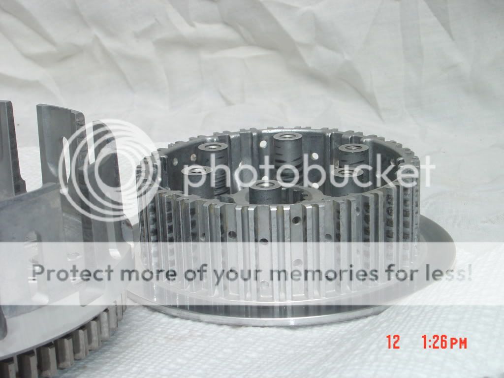

I had Surf and Turf Racing in Connecticut Mill my basket and inner clutch hub like a hinson they charge $50
