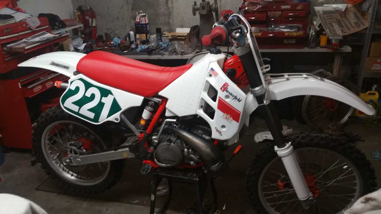

alright after making whole sale changes in my life in hopes to win my wife back, which has worked to an extent, I have decided that my 90 katoom needs to be resurrected. Doubt you can remember but she grenaded on me at a race a couple years ago and had shelved her due to frustration. Well she had been a litany of let downs before I put her away and after contemplating selling the old girl, the good Lord told me to rebuild her, so I recently purchased another crank from ebay to have rebuilt in the coming months, then its cylinder re-plating and I will  have her running again.

Wow that is nice!
How hard is it finding parts for those earlier KTMs?  I see some good deals from time to time but I always worry about parts.

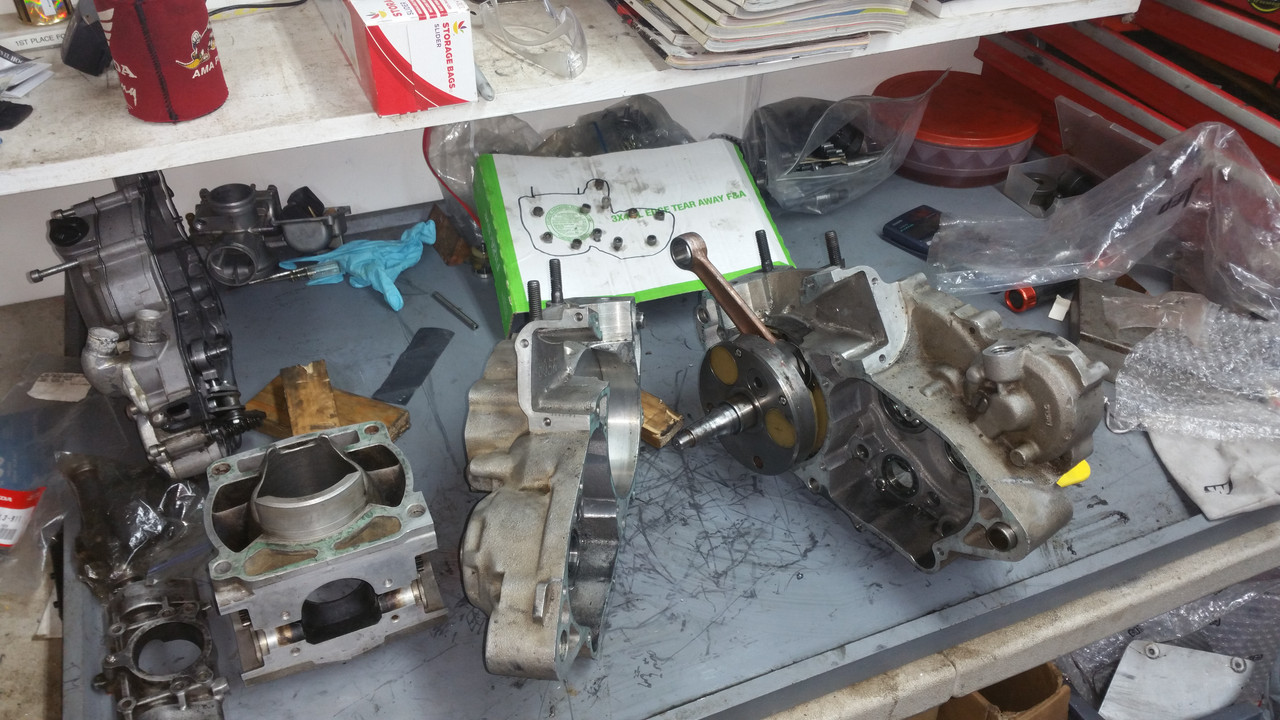

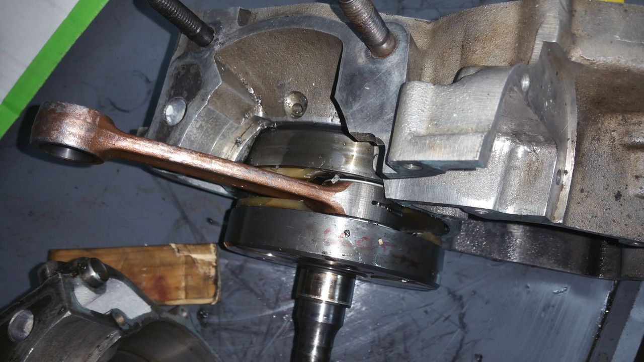

here are the cases split. Both crank bearings growly and another to the main main shaft. I think the rod is bent a bit but no worries, this whole assembly will be in the round file and I will start with a different crank assembly. I have the crank bearings, I just have to find them. I may have to order a seal. The crank rebuild will only cost me labor at about $150. Suggestions for re-plating?

Good progress!
On the plating, here is what I have at the moment:
