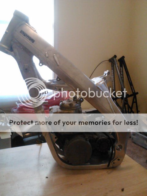

I'm rebuilding my 2003 CR250R.  As most Honda people know, the 02-07 RC Valve motor is a bit on the weak side.  Sure it can be "fixed" with loads of epoxy, different carburetors, ect. But, in the end, you end up with a "good enough" motor that still is not what the previous generation was.
So...... I'm swapping the motor and carburetor all together to the '99.
You can see my 03 motor was immaculate.  I ran a PWK Airstryker off a KTM250SX and a DEP pipe and that was pretty good.  Peaky, but good.
Surprising how close the mounts are.
My plan is to replicate this 2004 RC250M.  Throttlejockey is supplying the graphics and number plates.  I am using black wheels, and a '12 model front fender.
The bike has newer CRF Showa front and rear suspension which is being revalved by Bumpsticks tomorrow with some speed sensitive mid valving.

Do you have to mod the frame, or mounts?
I have an 01 engine and I'm looking for a gen 3 cr 250 but I was under the impresion that the 01 engine would bolt in.
CR250R......of doom. Testing positive for Beastmode
« Reply #8 on: February 01, 2013, 06:50:43 PM »
You have to buy or fabricate a headstay mount, and you have to ovalize the front mount tab holes about an 1/8th inch.
Yea, of course I'm rebuilding the thing myself.
