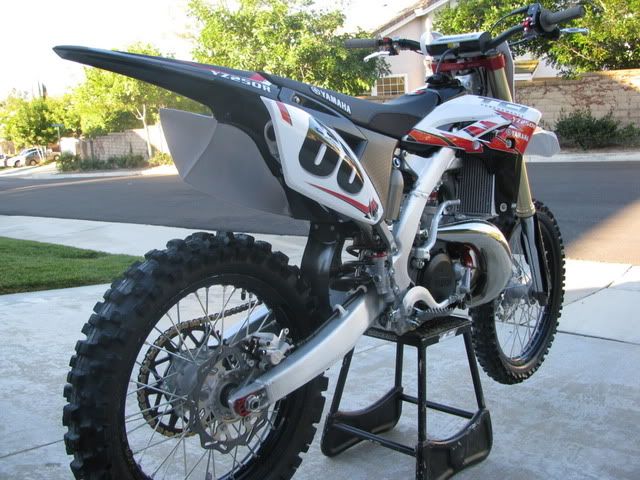

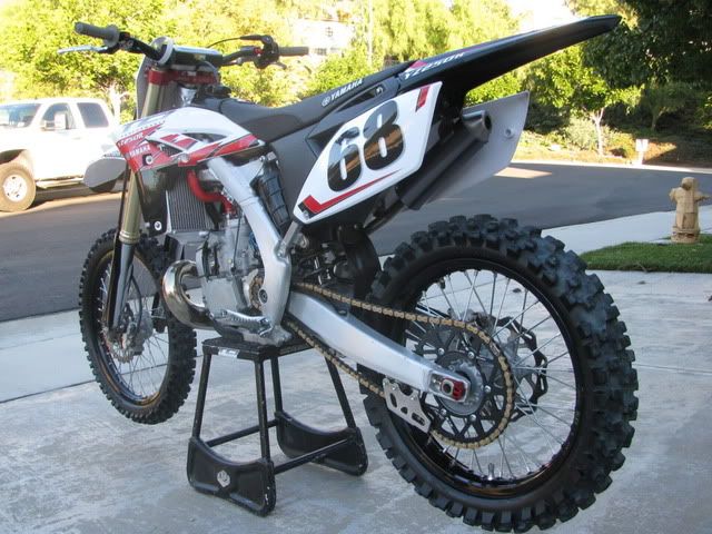

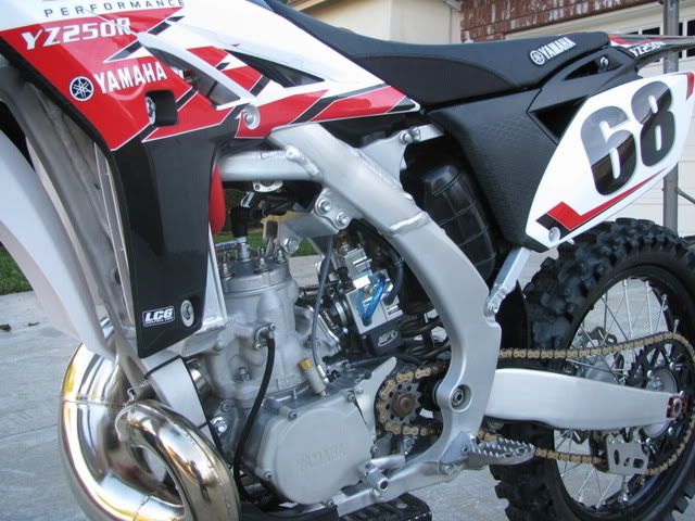

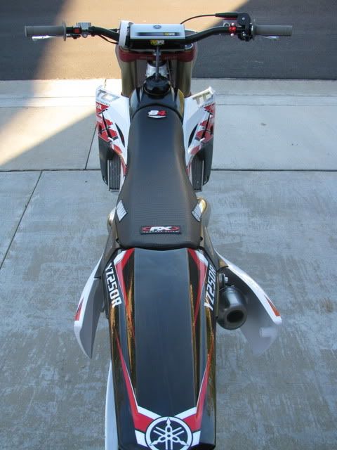

DONE!!!!  With the first few test session behind us the bike is working better than expected.
APT SmartCarb works awesome so far and we are heading onto the Dyno next week for data.
More info to follow within the next couple of weeks.
