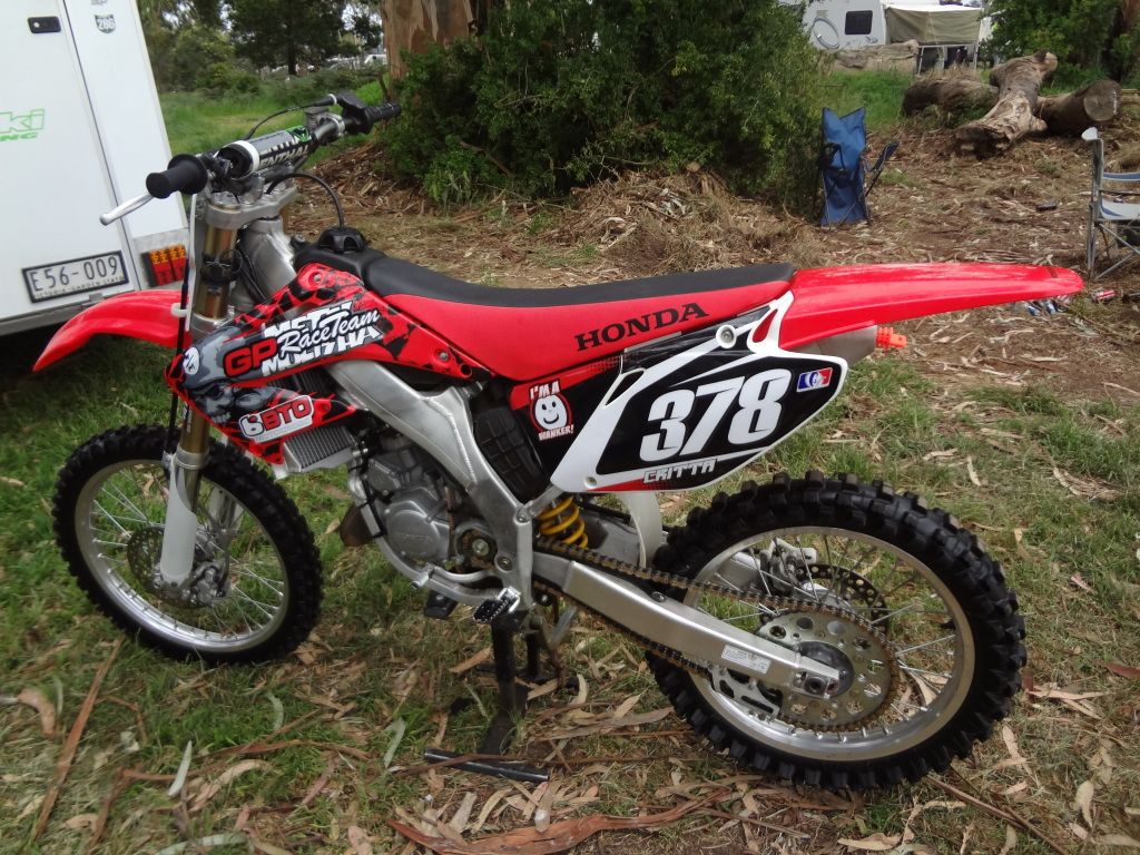

« Reply #52 on: October 28, 2012, 11:11:12 AM »
gave the big girl a bit of a quick fix until next season in the way of cosmetics!
your thoughts?

« Reply #53 on: October 28, 2012, 11:42:45 AM »
Very nice, like the sticker on the air box,  I'm a wanker hahaha :D

« Reply #54 on: October 28, 2012, 01:26:44 PM »
looks proper now.

« Reply #57 on: October 28, 2012, 04:55:31 PM »
Looks good, you could peal the melisha graphics off  and run the stock graghics which look great. If your going to add a different seat cover in the future, install the seat cover over the stock cover, that,s what I do.  A  04 125 seat works on a 06, it,s a tight fit tho, the 04 seat is softer and a little wider.

« Reply #58 on: October 29, 2012, 02:01:30 AM »
yeah i gotta get rid of the mulisha kit but i'm waiting until next season so i'll just beat these ones up while practicing for now and i've got a set of wheels sitting in the shed from my old bike that will look nice on it!
