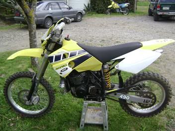

Here's a convertion for sale in kiwi land.
Yamaberg 490. :)
Heres the link to Add.
http://www.trademe.co.nz/Trade-Me-Motors/Motorbikes/Motorbikes/Dirt-bikes/auction-349364989.htm

its cheap too.
« Last Edit: January 27, 2011, 05:35:09 PM by factoryX »
Re: Super Hunky & Matt Cuddy Strike Again....
« Reply #21 on: January 28, 2011, 03:48:13 AM »
Nice bike.

That Yamaberg is awesome. You guys know that Berg is making two strokes now?
