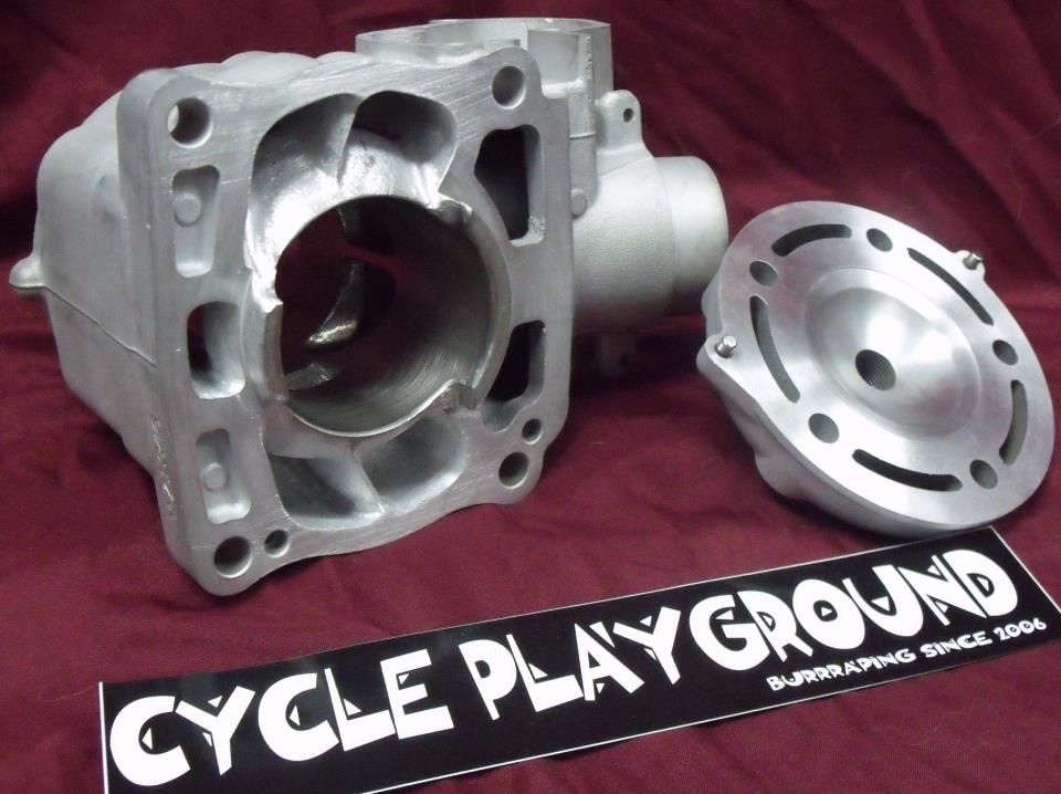

Cylinder coming back from Millennium Technologies and Cycle Playground:
Are you going to send the cylinder back to whoever did the "porting" because all of that fell out of favour in the 70's
All you ever do is bring people down, you pompous dick.
What do you do? Swing wildly between a sycophantic fanboi and a obnoxious cretin. If something is shit it needs to be said

Everything went fairly smooth.
Started with 400 main/ 35 pilot, middle clip. We ended up dropping the needle 1 clip, jetting is spot on.
We also had the front master cylinder blow out at the track, I swapped it with an extra I had.
The power surprised me, plenty from bottom to top.
The Wiseco/Boyesen/FMF combo make her sing for sure! We'll have some video coming soon
