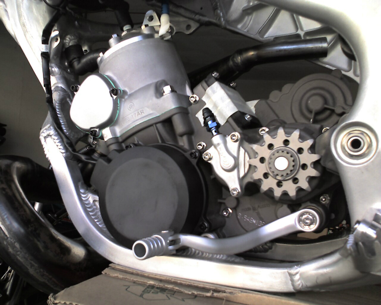

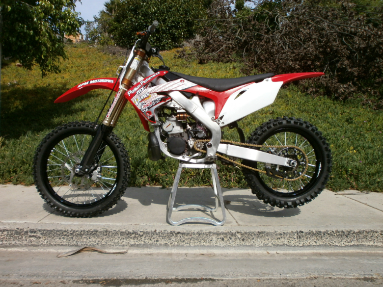

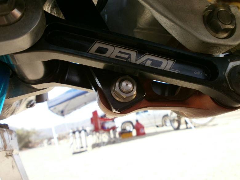

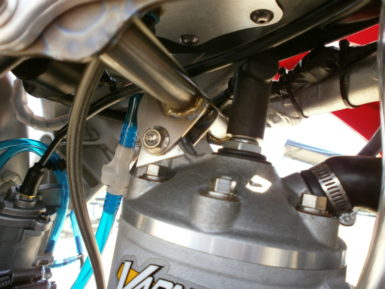

"I just wanted to share this amazing project with all of the two stroke fans out there. We just finished this factory level 2 stroke build after a year and a half of R&D, testing, changes, etc. The end result is amazing and we ended up with a 53hp rocketship that weighs 15 lbs less than the AMA minimum weight limit for that class! 201 lbs, ready to ride with an empty tank. We used a Varner Motorsports modified KTM 250 sx powerplant in a 2011 Honda 450 frame with production based Showa suspension including a SFF Showa fork, modified, valved and set up by MB1 Suspension. The entire engine cradle and billet engine mounts are hand fabricated and machined to accommodate the KTM powerplant. Racetech Titanium was instrumental in helping bring the weight down with all of their titanium fasteners, axles, brake piston and pivot hardware. The bike also utilizes many one-off titanium or alloy parts and heavily modified OEM parts as well. DLC coatings were utilized in many critical areas including the shock shaft, brake hardware and pins, brake pistons, select transmission parts, titanium linkage pivot bushings, and swingarm pivot bolt to name a few. It took over 500 hours of trial and error, testing, changes, extensive mods and many hours of scratching our heads to get it perfect but I feel this is the most refined 2 stroke conversion build anyone has ever done. "
"My vision was to create what I thought would be a factory level two stroke offering if they fielded one today, so I agree with you 100% "

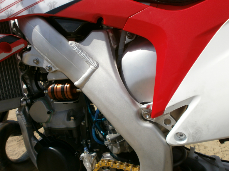

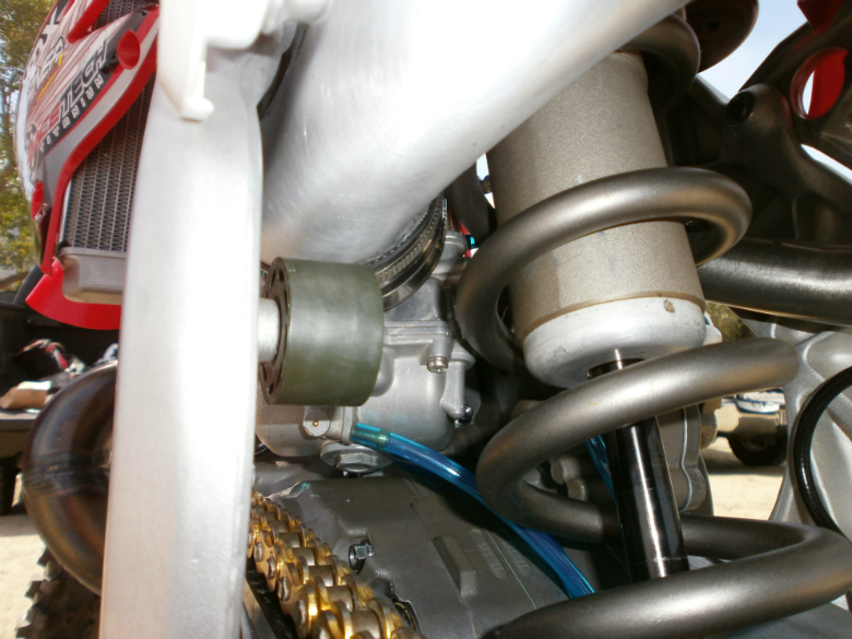

"The first to create an aluminum airboot as far as I know but I'm not sure. It was the only way we could get the intake to line up correctly without compromising intake boot volume and also clear the shock, chain roller, etc. I didn't want it to be hacked together like most conversion bikes I've seen. It was more of a solution to a problem than anything else but it turned out sick for sure. Saved about 1/2 pound over the stock setup too. "
"You would be surprised how it stacks up against 450's. It is incredibly fast and not as hard to ride as you might think. KTM did an amazing job when they designed the latest generation 250 two stroke and they make a lot of useable, linear HP. It will pull most of the 450's on the track on fast 4 gear + uphills. Varner did an amazing job with the porting and head work and we use a JD full race ignition as well. It has hurt more than one four stroke riders feelings out there I can assure you. "
"I agree the thumpers have made huge advancements in recent years but its not just about HP either. The same rider can carry far more corner speed on a 2 stroke vs 4 stroke because of the lower weight and lack of gyro and therefore eliminate the need for so much power. I think this is one of the reasons we are seeing faster lap times at many of the nationals and SX races from the lites class. They just handle much better and they don't feel like such a pig because of the higher RPM's and the lighter crank, less inertia, etc. Just a thought, no way to validate that however.... "

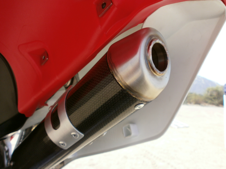

All that money spent and yet they thought a $200 shitty off the shelf pipe would suffice... facepalm.
crf/ktm 250sx hyrbrid drool worthy...
« Reply #12 on: November 01, 2012, 11:43:48 PM »
HA! thats true too. Surely they could've pulled a custom made cone pipe out the of the hat. That really would have been the icing on the cake.
