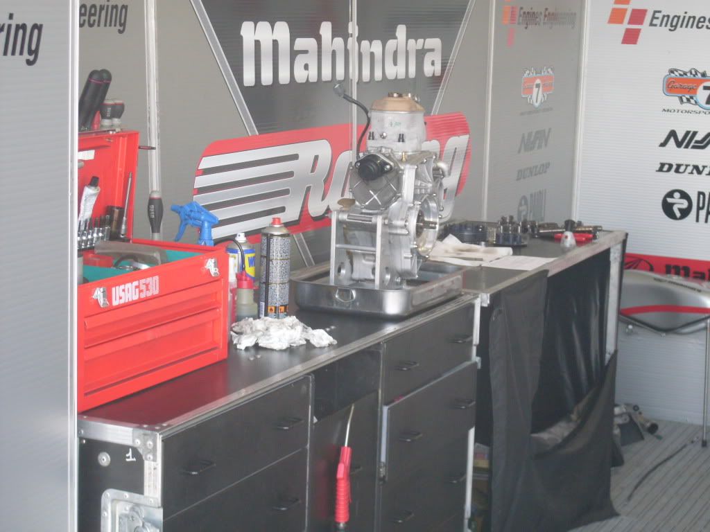

Sounds like a good weekend. ;D
Question. What motors are the Mahindra's running ?
I understand they have entered the 125's this year to get ready for Moto3 next year.
What will they be running next year ?
P.S. Well done Casey. ;D
Never used to rate him much but he has changed my mind. :<img src=" title="Roll Eyes" class="smiley">
I think he is 5th on the all time premier class winners list.
Thats damn good.
Better than good, I always wondered what the Mahindra ran but it appears to be an Aprilia RSA engine. I don't know(or care) what they will be using next year, though I have heard some rumours.
