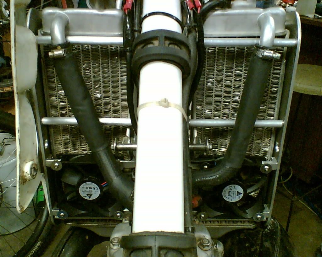

Something to think of is fitting some fans. A pair of computer fans, with an RC car battery ( seems everyone's got access to RC stuff) will keep things from boiling. It would cost you bugger all to set them up, and really help you from killing the little engine. I've used computer fans now since 2006, and even though I thought they'd cark it instantly, I'm still on the same pair, despite a few drownings in muddy rivers, and constant exposure to Australian dust.

the computer fans work better, and are more out of the way, mounted to the rear of the right radiator (the one with the cap) pulling air through. it is also possible to power them from the throttle position sensor curcuit since they are such a low voltage.

Yes, fans can pretty much eliminate boiling / overheating - the higher altitude you go, the more likelihood you have of boil overs. despite ambient temperatures.Without the fans, my bike still boils over mid winter, and in the once or twice riding in the snow here.It snows a few times each year in the Blue Mountains, 100km from the centre of Sydney, which even most locals don't realize. Here's a pic of my mounting - I do it properly, mounted to my rad cages that I make, but plenty of people just simply cable tie them directly on their rads. Connect them to a battery (as I said, lots of people have RC car batteries and their related charging systems) - you can get 6V, 12V comp fans for less than 10 dollars each, a couple more dollars for some wire and fittings and off you go. My 500 is a steamer of epic proportions in my near trials type terrain , I tried multiple solutions, such as full alloy water lines, to increase fluid capacity and 'radiator' surface, all types of fluids (not Evans - I did not want to just let the bike run hotter and hotter), 1.8 rad caps, 2 catch tanks etc, etc- with the fans - no more problems. Ever. I've a stator system to run them, but to me a RC battery pack would be very easy to set up.

That fan setup is very cool. We will be around 10500 up to 12k something, theres a trail/4 wheel jeep road that leads up to the lake.
