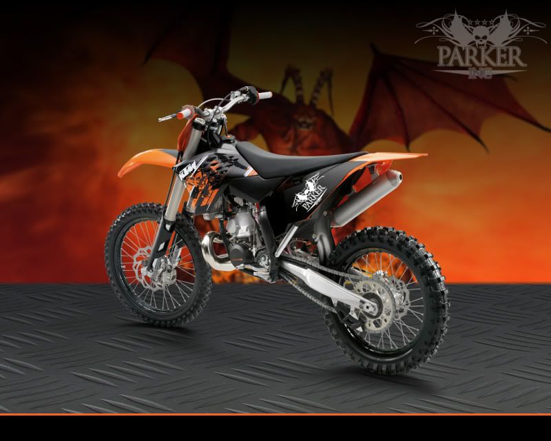

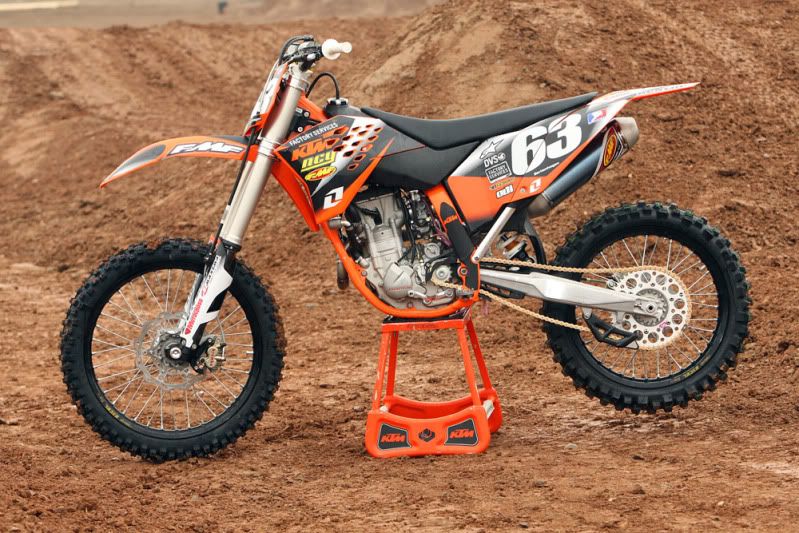

Hey 2smoker... whats the deal with the 4 stroke KTM photo?? Is that on your wish list?? :P :P
Re: Update to the AMA Rule of the week!!
« Reply #21 on: January 05, 2010, 10:54:48 AM »
hahaha sure John! Like the Orange frame! This is it!
What about this one?

« Reply #23 on: January 05, 2010, 06:34:05 PM »
Now that is a sweet bike!
