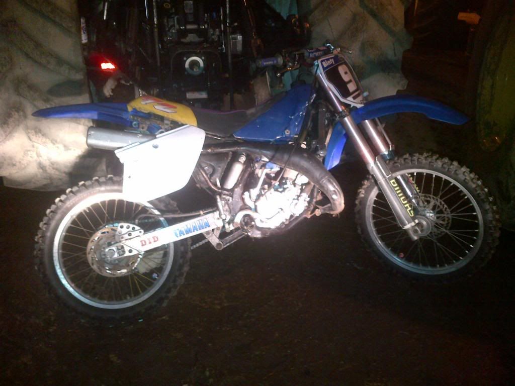

Bought the YZ I was looking at!
Seems to be in reasonably good nic considering that I only paid £300 for it.
Suspension is in mint condition, gearbox seems fine, engine turns over with plenty of compression however the seal on the air filter is crap so that will mean it will atleast need a topend (which it would have got anyway) and it needs a new cdi before it will run. Also the previous owner thought it would be a good idea to spray paint the fuel tank blue (I have now powerwashed all that off now) and to fit newer style plastics using zip ties.
My plan is to take it back to its original looks while applying some modern technology to help it fight against its opposition as I do not plan on racing this in any evo class races but instead in the local races which are put into classes based on our skill rather than the bikes we ride so I have to be competitive with 450f's.
PS Charles would I be able to use the TSM logos on a graphics kit for it, Chesterfield style but with TSM rather than Chesterfield.

You sure it's a '89 and not a '90 ?
Title: 1989 YZ125 Project Bike
Post by: gpnewhouse7 on February 21, 2013, 09:06:56 AM
No not really, how do you check?
Post by: evo550 on February 21, 2013, 10:35:32 AM
The front end is a '90 model and pipe "looks" like it follows the '90 route.
Check the 10th digit on the frame number a "K" is '89 a "L" is '90.
Eng number for '89 starts 3jd, for '90 3sr.

Post by: scotty dog on February 21, 2013, 01:09:29 PM
90's had red forks too, that's  if they're the originals

Post by: SachsGS on February 21, 2013, 02:52:30 PM
Interesting, you still have the 50mm short stroke motor.

Post by: evo550 on February 22, 2013, 12:00:27 AM
3XJ enigine number would make it a '90 frame with a '91 motor...

Post by: Coop on February 22, 2013, 02:30:47 PM
That is what I was going to say, 1990 model had red forks.
Use this site:
http://www.motoverse.com/vinDecoding.asp

Got started stripping down yesterday and discovered a few little niggles that need to be fixed:
Yes that is filler on that exhaust but thats not going to be a problem when you see what happened when I grabbed the silencer to turn the bike around.
The is also silicon plugging holes in the right hand radiator and the left isn't much better.
Silicone also seeems to be plugging holes in the cylinder and on the magneto cover.
Also looks like I may need to make some new headstay mounts.
And fix the frame/exhaust mount.
Apart from all that she's pretty much brand new haha, fuel tank is looking better after a quick powerwash.
Oh and I couldn't help but laugh at this.
More updates to come tomorrow.

It's your baby, but my advice would be part it out and get your money back, before you live to reget it. It's going to take serious coin to have it back to decent condition and you will be left with one of the slowest 125's ever made.....Just sayin'

That headstay has alarm bells going off, I haven't seen that on a 125 before :o
have you checked the frame for cracking..or more like breakage than a crack. Might have something to do with the engine swap though.
