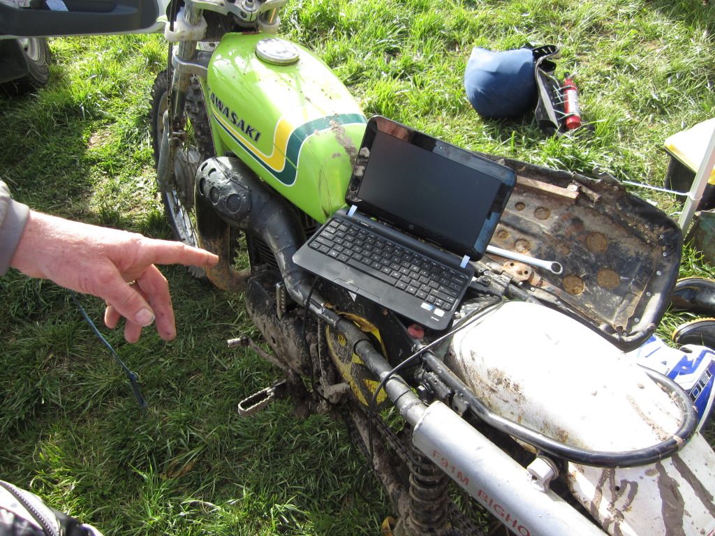

The bike I have fuel injected is Kawasaki 350 B
ighorn 1973. This only a test hack. A VMX bike.
Uniflow. Are you going to Whakatane on the 6th Oct.?
I'll see you there if you are.
Yes I'll be there. If I don't wreak it first.
Ignore the bike. The EFI that it run's on now is off the shelf components, Link EFI, car injectors, bosch fuel pump, Subaru relief valve.
You can see the injector nozzles in the in the back of the crankcase ( x2).
You can see the injector bodies in the intake cavity behind the cylinder.
Flywheel side, one censor run's the ignition ( Ignitec ) and the other run's the EFI system using a 12 minus 1 trigger wheel.
This bike has a vairable rotary valve housing operated by the Ignitec ignition. From 55 degrees valve closing at low speed to 78 Degrees at full throttle.
Cylinder head.
Fueling changes. Link EFI has the ability to change the fueling as the head temp changes. With Ethanol the fuel requirement changes above 70 degrees C, more fuel required. This can be changed on a graph that uses TPS and Temp. This information is overlaid the main fuel map. Very handy with an air cooled engine.

Hey Uniflow, why did you make the intake port timing variable as opposed to the exhaust port timing?
Uniflow did you put the hole in the upper rod end of the crank? If so was it hardened and what did you use to do it. Thanks
The rod is a Hot Rod, to suit a Polarus trail boss. Five mm longer and I had to bore the crank flywheels out one mm. I offset the holes half a mm to get an extra one mm stroke. It is a much better rod than original. Piston is also Wiseco trail boss.
An exhaust power valve would be next on the development list.
I think this engine is as far as I want to go with development, I only did it to see if it could be done, EFI that is. I bought a YZF 250 to start the next development, throw the engine out and fit a 350 twostroke with EFI. This new water cooled engine will have a powervalve and I would like to use the vairable rotary valve again as it shows good results. Probably will run it on ethanol again as well. Trouble is, Meagan my daughter thinks the YZF is her's now and is using for trail riding. The new engine will probably take a little time to build up anyway.

Well I'm trying to wrap my head around this and understand how it works, If the fuel is being placed in the injectors and not the rotary valve via a carburator.How does the rotary valve work in this application? Thanks
Some AL frames are 7000 series which is self hardening. You are right about the 6000 stuff, lose the T6 and it turns to silly putty.
7000 doesn't have good fatigue resistance. Bicycle manufactures have moved away from 7000 series now, 6000 heavier but lasts longer.
The rotary valve still organizes the air into the crankcase, just has no fuel with it. Oil is still deposited from the injected fuel around the crank case and rotary valve via deposits in the transfer ports. One of the problems with the Link computer is some it's twostroke injection timing software is not operational yet. I can change the start of injection timing to a given point with the "on time" moving away from this point. I'm injecting approx over 180 degrees at full throttle (180 degrees injector on time ), so I have to set the start at approx 20 degrees after TDC ( quite a way before transfers open) so that at full throttle there is no injection still happening after transfer closes. If injection occurs after transfer port shut the fuel mixture on the next cycle is not so accurate ( power loss ). This I have found. Best it to have a fixed shut time ( approx 30 degrees before transfers shut ) and have the injection start vary. This will bring max injector start time to about 30 degrees ATDC at full throttle. This is what is needed, as up to about one third throttle is happening as the transfer is occurring. This I have found gives best bottom end power. Clear as mud?
If I ever get my bighorn project of the ground Ill have to look into your set up a little more. We were going to try and mount a 800cc twin snowmobile cylinder onto the bighorn bottom end to try and get more power.
One problem I found with the bighorn rotary valve was that it is difficult to increase the area of the inlet passage (at the disc) to equal that of a 44mm carb (or a 44mm throttle body). I found that you could increase the area to the equivalent of a 41mm throttle body via widening the inlet of the stock disc cover.
How did you overcome this? and what size throttle body are you running?

Have you tried injecting a BDC that is when the pull from the pipe is strongest.
It all sounds extremely confusing to me but it's good to see it can be done, good stuff
In a nutshell, the injection timing is important. I can see why it's probably a good idea to use a small and a large injector, staged. The Link software is not able to do this in " twostroke mode" . Also there is an option to nail down the injector finish time and adjust the start time, or a center and adjust either way from that point. Also not available in twostroke mode. These options are available in fourstroke mode. So next step is to call the bike a fourstroke twin, 360 degree firing ( I don't need to use the ignition as this is done with a separate unit), This will use two drivers ( switches ) in the Link unit to run each cylinder ( if it were a twin ). Both drivers can be hooked together to run my pair of injectors each 360 degree cycle. This requires a cam sensor, I'll use a circuit called a flip flop connected to the ignition trigger ( single pulse per rev ). This circuit ( flip flop ) will only allow every second pulse to be seen by the Link computer, as far as the computer is concerned, a cam sensor. This will trick the computer in doing what I need it to do. Now all these options will be available. New Link soft wear will be available in eight months. I can't wait that long, I want it now.

Did you consider using Ignitech's combined ignition and EFI ECU... the Ignijet? How hard/easy was it to nail down the fuel maps to give good running across a range of temps and conditions?

Yes I did think of using wobbly's ignitech unit. Cost a little more than the Link. I've used quite a few link units in the past on the Subaru powered gyro copters we build and have a good working relationship with the guys at link. But I was a little disappointed that the Atom unit I was sold did not have the suitable soft wear activated even though I was told that it was when I bought it. No problem, as it will be available in the next soft wear release. At the moment I'm "tricking" the computer into doing what I want. To be fair not a lot of after market computer makers have had a lot to do with transfer port injection where timing is so important. It is interesting to note that the default setup for injector timing is batch fire every 180 crank degrees ( fourstroke car engine ), this timing is random every time the engine is started. Once started it stays constant, but next time you start it will locate somewhere else. You can imagine the issues this caused, trying to tune this type of setup was impossible and it took a while to sort it out. I ended up making a device to strobe the injectors on and off points. Link's experience with twostroke injection has only been with snowmobile engines injecting into the intake ( an electronic carburetor ) where injection timing seems to be less important. You can appreciate I've put a lot of time and thought into this project.
How hard was it nail down tuning? Well it's still happening, some of the problem has been the computer setup as stated above and some the ethanol fuel I'm running ( too many new things at once ). Ethanol has the odd requirement for more fuel above 70 / 80 degrees C ( engine temp ). Water cooled engine you would never notice. Air cooled, at 120 degrees it becomes very lean so more fuel is needed. This is were the computer is soo good as it can easily be setup for this. This was always the problem with the MFI system I had previous. Very rich cold and early in the race only to come right at about two laps in, very frustrating! Now we can fuel it so the engine never sees 120 C.
