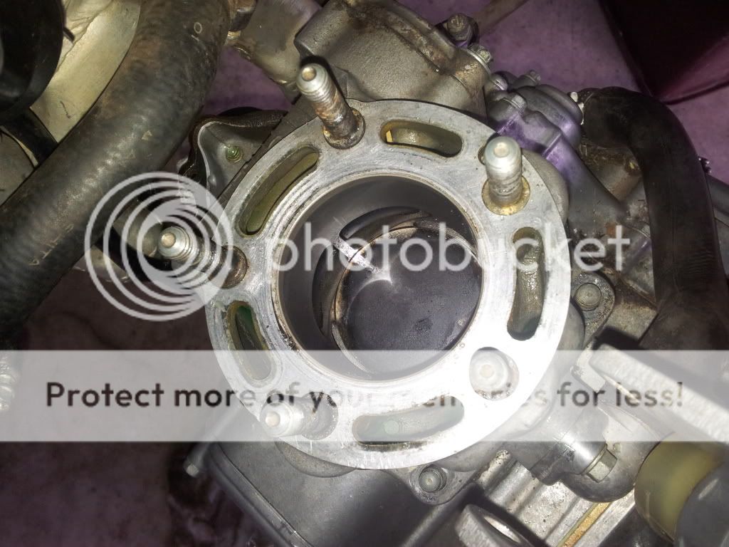

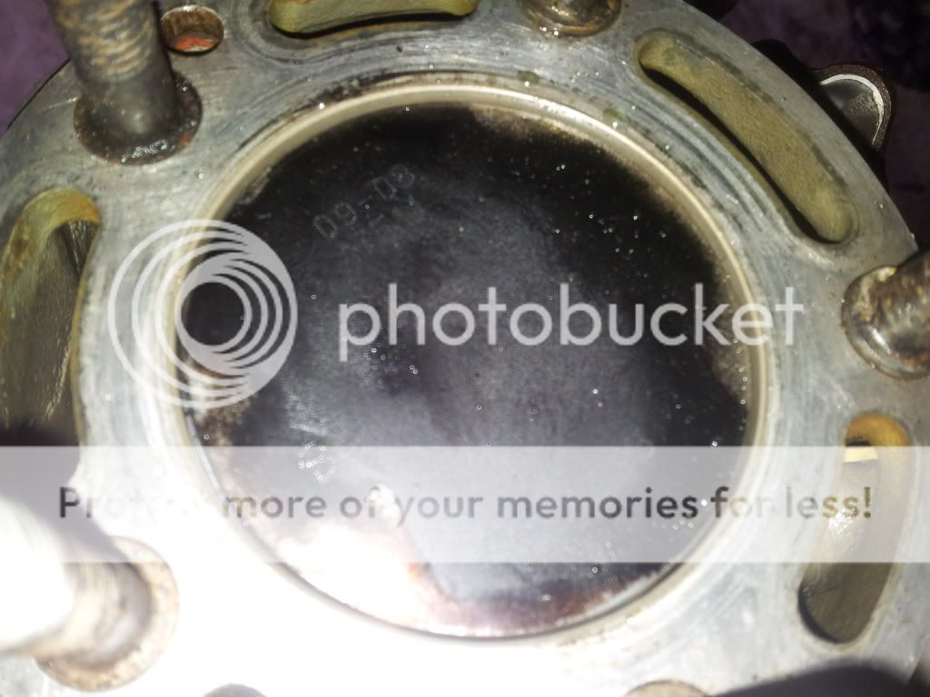

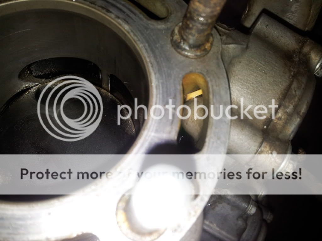

Its hard to see the piston there but it looks fine.
It looks like its sleeved, whats the verdict? in the event it is sleeved, wouldn't that make the piston the CORRECT size?
