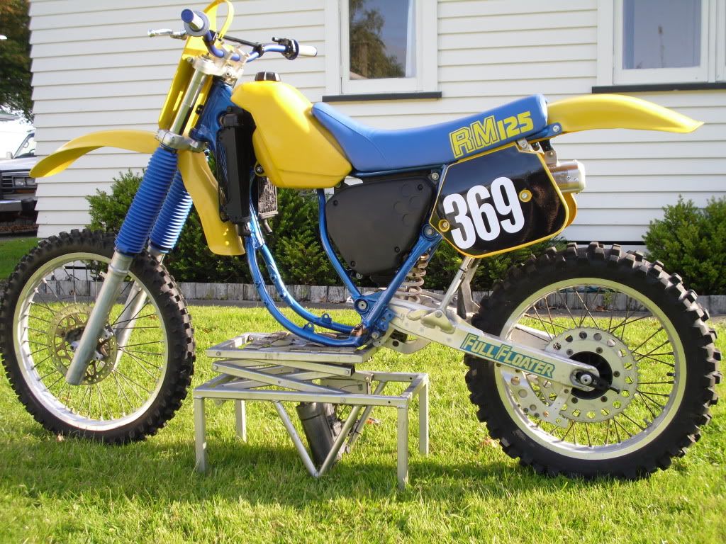

I have started the rebuild on my 1984-85 RM125. I have 1 bike complete (above) and 1 spare frame (below).
Plus about 6 sets of plastics.
I have also bought this 84' which I pick up on sunday.
The plan is to build 2 complete bikes and have a spare bottom end.

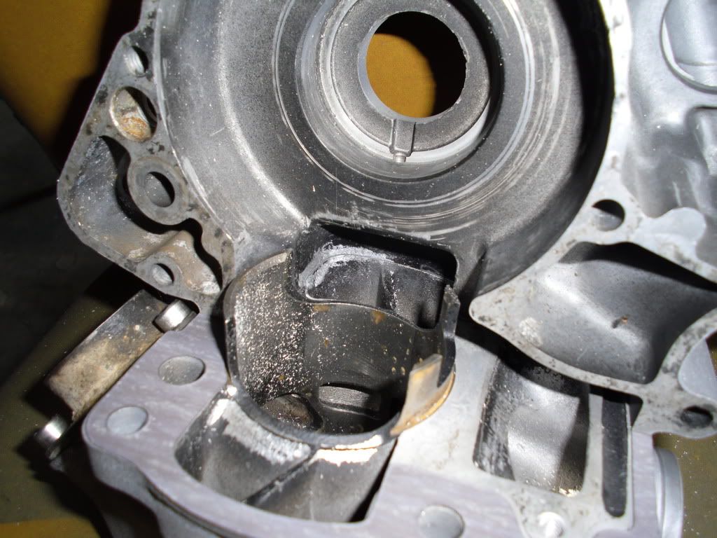

I pulled the 2 motor's apart yesterday and the 85' engine is in pretty good nick.
The bore is in good condition so I just need a piston & rod kit for the top end.
The clutch basket & hub are good as well as are the plates. So don't need to replace any of them.
The tranny is all good but I will replace all the bearings and seals anyway.
The motor will get a full rebuild of all bearings and seals.
Don't want to have to do it again in a hurry.
The 86' motor is in similar condition except a couple of gears have lost a bit of hardning.

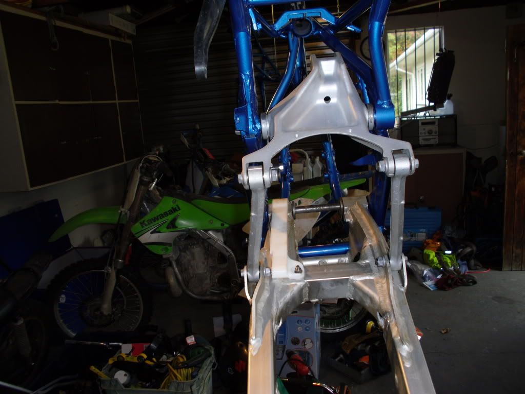

Sachs. The only thing I am having problems finding are the linkage arm bearings.
No body does them that I have found.
All-Balls do the shock bearings but they are a different size.
I don't want to pay OEM prices.
Ideas ?
If you know bearing dimensions or bearing p/n give these guys a try: http://www.vxb.com/Merchant2/merchant.mvc. These bearings are made in China so take it for what it's worth. I'd use them as a last resort.
The linkage bearings are a different size then used in most feilds.
I can get sizes close but not close enough.
They are not to bad actually so if I can't find any I will use what I have.
They are not actually bearings as such, more a spherical rod end.
Oh yea...a spherical bearing. Yea...that may be a little difficult to source. I got this picture from Motosport.com but Service Honda also has the very same drawing.
Suzuki had the nasty habit of custom manufacturing bearings to odd dimensions so that that they could not be sourced at bearing dealerships and were, as a result, very expensive. You can imagine my relief when I started riding Euro bikes again and every bearing was readily available.
If you still have your lathe you could machine sleeves to adapt the odd O.D. of the existing bearing to an off the shelf generic bearing - usually you can match the width and I.D..
When I raced an RMX I remanufactured the whole bike to get around this issue.
Yep. Thats what I will end up doing.

All sorted on the link arms. The 84's are perfect and I will machine up some inserts when I build the other.

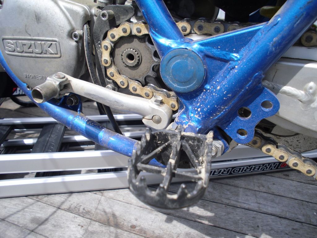

I was trying to figure out the best way to modify some pegs to fit so I could get rid of the 1/2" wide crap standard one's when I had a brain storm yesterday and I will copy my TM pegs and make some out of stainless steel at work. Should look the part.

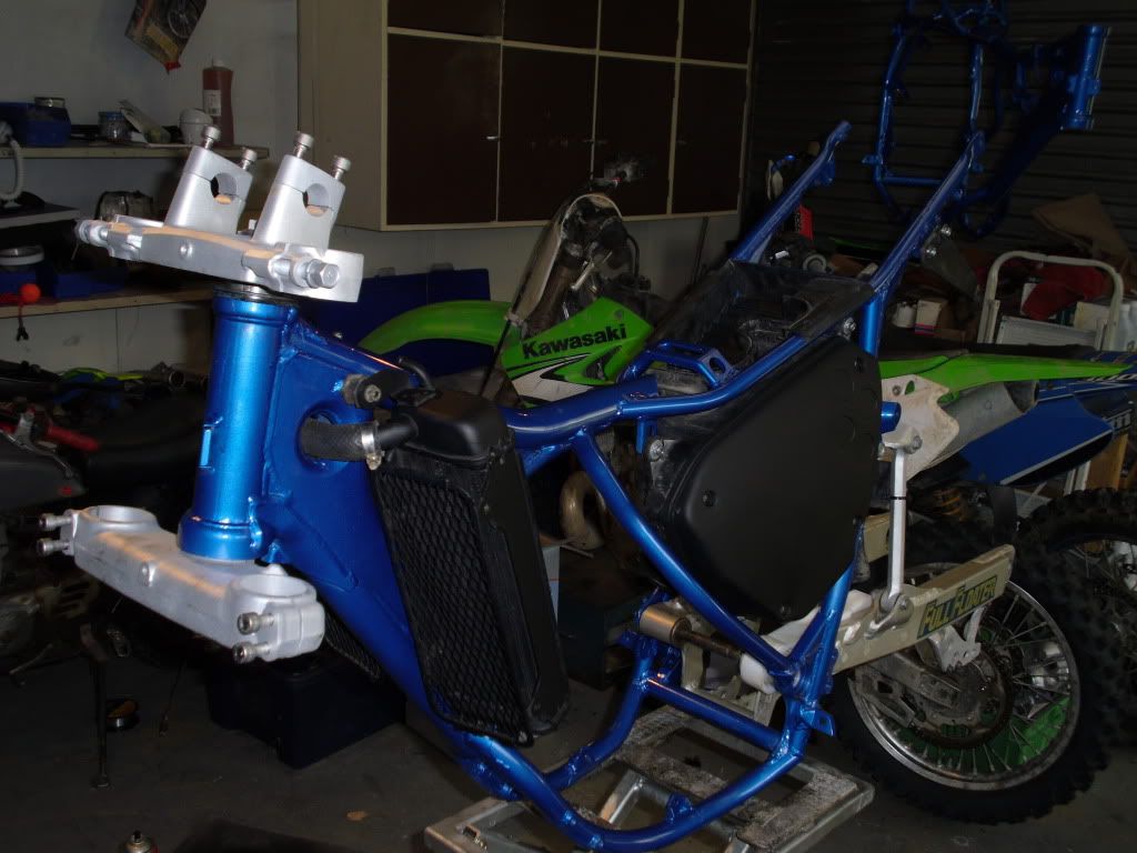

I picked up my frames from the sand blasters today. I have a couple of small cracks to Tig up on saturday and 1 of the frames has an engine mount tag broken. Nothing major will have them ready to prime on sunday.
I have also bead blasted all the Aluminium parts for both bikes. Engine , fork tubes , linkages etc.

Tig welded up the small frame crack.
Frames ready to be primed. (I did that tonight , photos to come.)

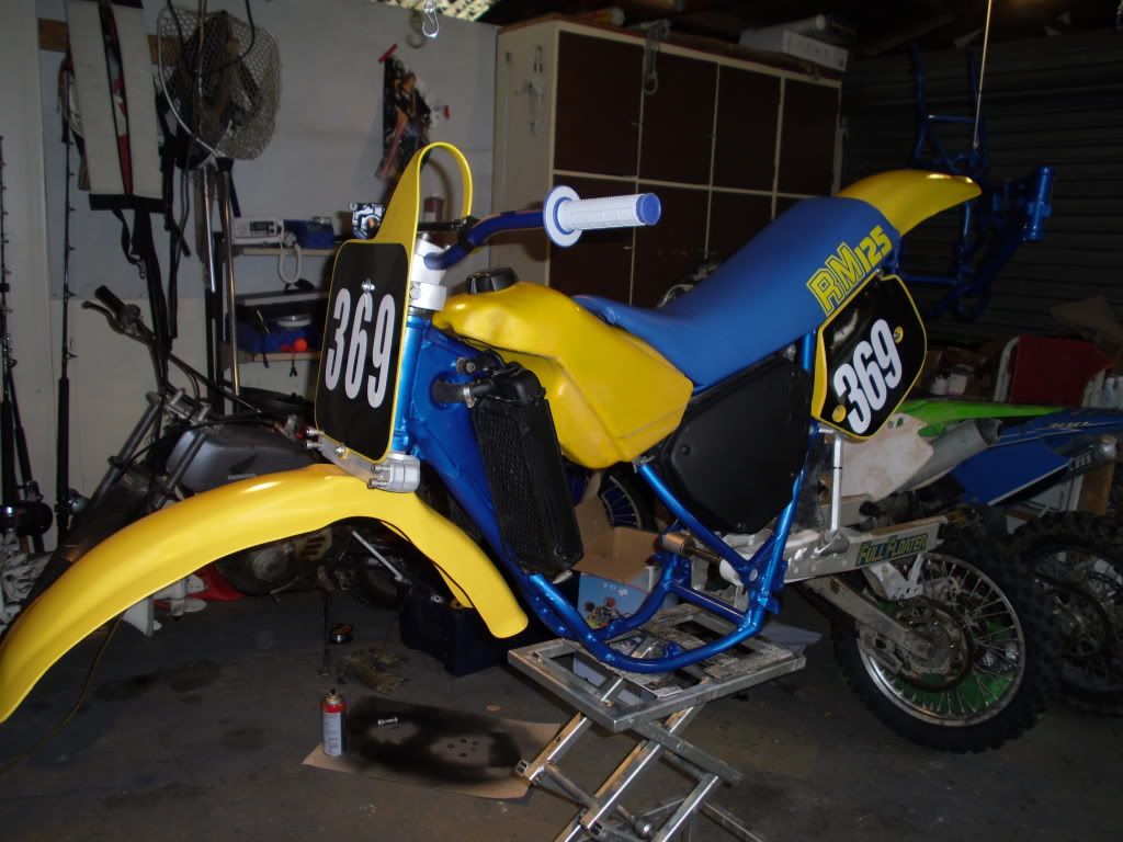

It warmed up enough today to paint the frames.
I choose a 2 pot metalic blue used on later Suzuki road bikes.
I liked the colour and thought it would look abit different to the normal pale blue used on the early RM's.
The first photo is what the colour looks like. I had to cover up the flash.
Photo's with the flash make it look lighter then it is.
I will pick up some new stainless cap screws in the next couple of days and start to throw it together.
It is always more enjoyable when things start to go back together. You can see the progress.

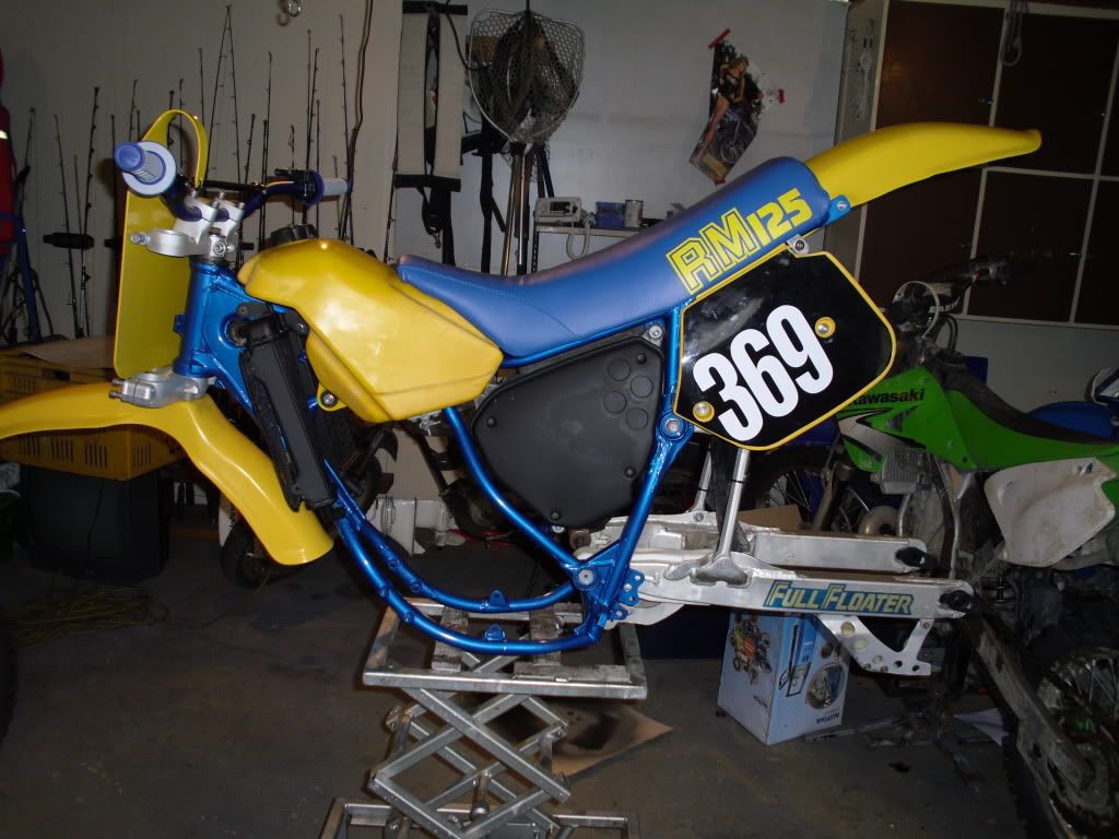

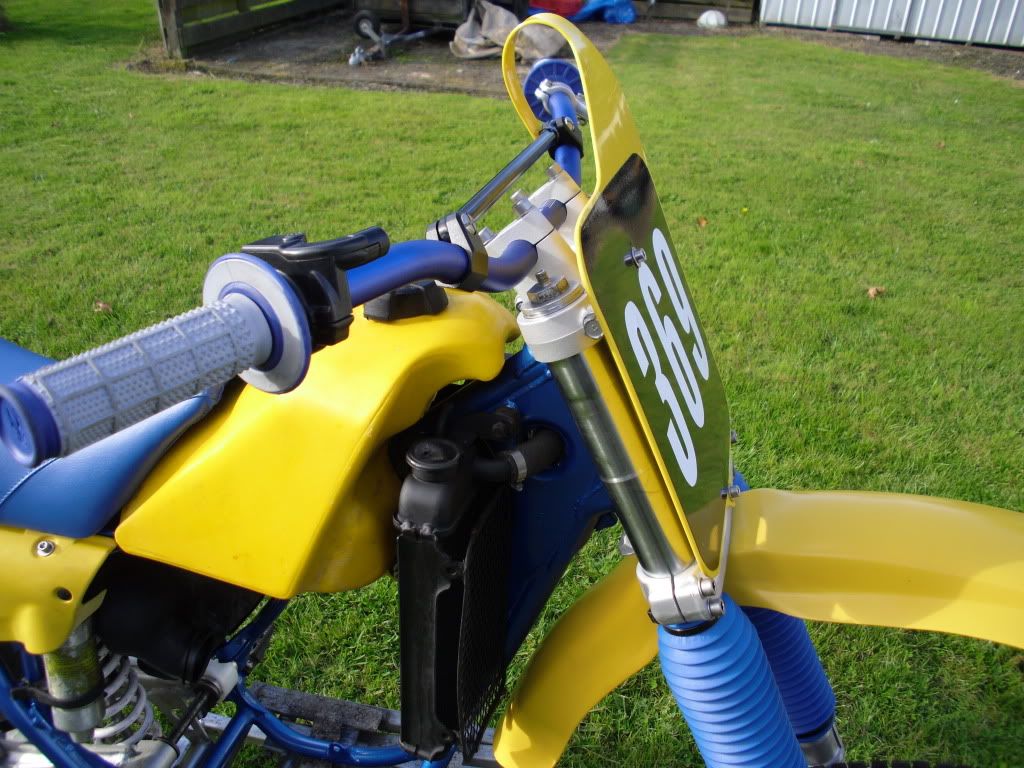

I noticed yesterday when I was mucking around that now everything is bead blasted the front brake master cylinder & caliper now look like shit when fitted to the legs.
These were the only things I did not do.
So if you want to bead blast a bike like this you will need to do EVERYTHING.
PS. There are no scratchs on the 3rd photo.
Just reflections.

Started to throw the frame together today.
The Full Floaters bolted in. Swing arm bearings have all been replaced.
Triple clamps, Radiators & Airbox fitted.
New Guards,Front number board, Seat, Bars & Grips, backgrounds & numbers.
With a bit of luck I will get the rebuilt forks in tommorrow and fit both wheels.
A few little things like brake lever and rear support to do then I will start on the engine.
Starting to look like a bike again.

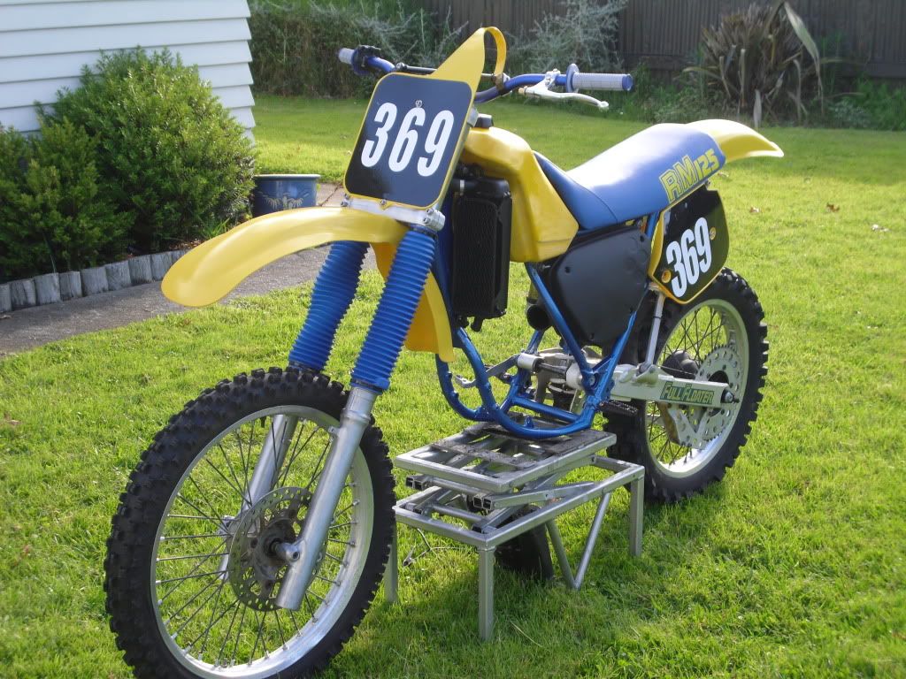

Well the bike has made it into the light of day.
I havn't bothered doing anything to the wheels at this stage. They have good tyres and run true.
I will probably respoke them at some stage. This was always going to be a race bike not a museum piece.
The rear hub is very good and it has new shoes & the disc is mint. The front hud is not painted black as it should be but don't want to respoke yet so it is staying as it is.
Don't worry about the shitty looking shock as the other is getting rebuilt. It is just holding up the arse of the bike.
Pretty much all bolts have been replaced with stainless cap screws and washers.
I have to get the caliper & master cylinder bead blasted next week so I can fit them up. Or I might even paint them up black.
Next is to reassemble the engine.
The shrouds are missing as they are at the graphic guys. Will see them in a couple of weeks.
I might as well go have another beer now.

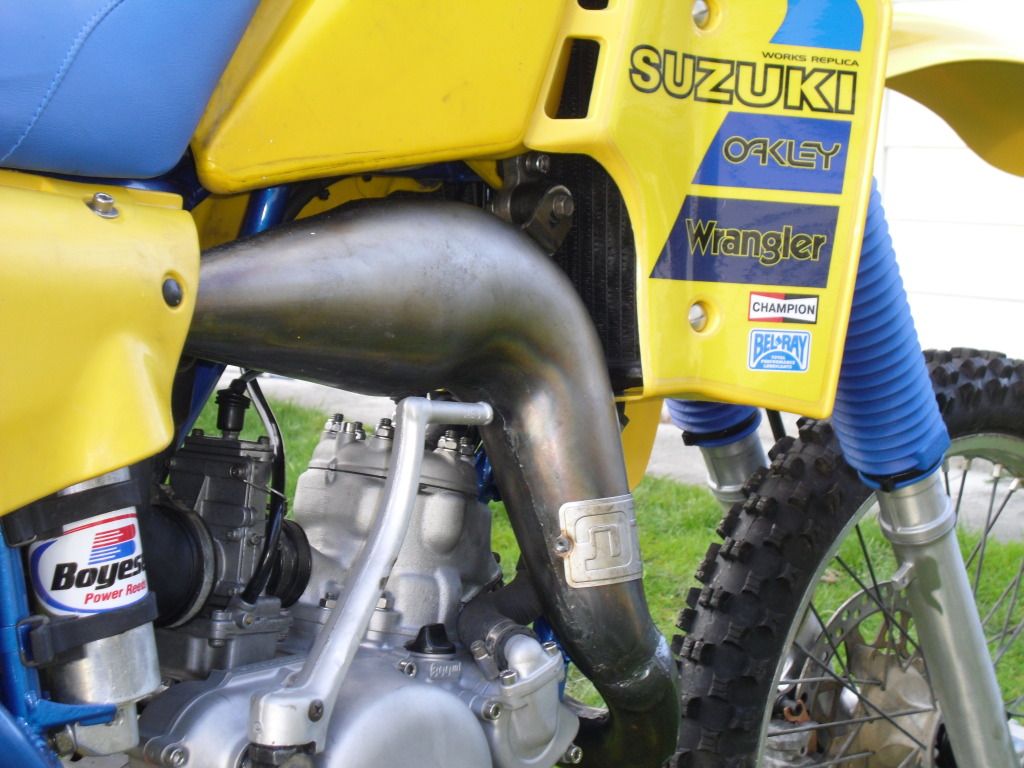

What are you doing with the engine? Have you got a stock pipe?
I have all new internals and will put the cases & barrel together and cc the head. Check the squish and machine the head to suit. The ports have been tidied up before so will leave alone. Have some new Boyessen reeds. I will need to find out some jetting specs once i get it closer to running. I plan on running it on Avgas & H1R @ 30:1.
I have a new full DG system.
The reason I ask is many times I compare the weight of a stock system v's aftermarket and normaly the stock pipe is much lighter. The lighter pipe will perform much better especialy off the bottom of the rev range.
The DG pipe weighs 1.5kg and the stock pipe weighs 2kg.
The DG muffler is also alot lighter then stock but is on the bike so haven't weighed it.

So I decided to start on the engine.
I cleaned up the ports a little. just a few casting flaws.
The liner matches up to the ports nicely.
Matched the cylinder to both cases.
Not much was needed but might as well do it right the first time.
The worst parts were the exhaust flange, which overlapped the port on 1 side by about 3mm. Abit of grinding had that sorted.
And the carb intake boot was also about 3mm too small on 1 side. So that was grinded back to match the carb and intake. The motor will flow nice now.

If the pipe is light it should work good, but leave the step at the exhaust/flange (if it's not to late) a 2-3mm step actualy creates bottom end and helps a bit with top end. On modern engines the step is put there deliberately. Something you can do is grind down where the liner meets the transfer ducts so instead of a small radius you have a large one. The larger the better
The step was in the flange not the port.
In other words it was restricting the port as in was a smaller diameter. Only on about 1/3 of circumference.
You are talking about an oversize flange or larger diameter. Are you not.?
No I'm talking about the where the exhaust flange bolts to the cylinder, it's a deliberate mismatch and is far from a 'restriction' IIRC the RM pipe exits on the left with a angled exhaust duct to the left? Was the step was on the short length into the exhaust duct?
The exhaust duct is straight out. No angle.
But yes the step was on the short side of the pipe.
I have ground it out on the flange, but I do have 2 more flanges.
I keep thinking of the old air cooled models. I see the flange was smaller than the exhaust duct outlet diameter?
? Have I got that right?
Stop confusing me.
The diameter was actually the same but the 3 flange holes were not centre so it overlapped on 1 side.
Not anymore.
Now it has a smooth transition from port to flange.
Needs a step there at the meeting of the flange and the cyl, works much much better than a smooth/matching. A Honda RS125 looses 0.5- 1HP when you remove the step.

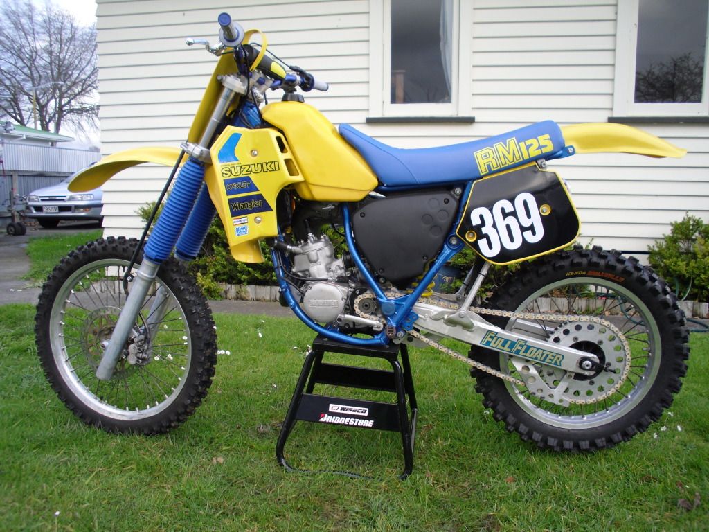

Had a good run the last 2 days and have managed to finish the old girl off.
Have fitted the 85' head and piston which is a flat top with a different squish then the 84'.
Head has been machined to clean up years of abuse and to slightly change the squish band.
New twin air filter , Renthal R1 chain , new rear tyre and tubes front and back.
Started the bike up and did 2 heat cycles and it seams to run sweet.
I need to adjust the clutch ( plates are sticking ) but I need to get to a track to finish that off.
All in all after a lot of hard work I am happy with the outcome.

I gave up on the idea to make some stainless footpegs as I don't have the time.
Although they would look cool I found a set of Crome Moly pegs off a WR for $40.
I cut the mounts of my old pegs & the mounts of the WR and welded my mounts to the WR pegs.
Total time about 30 min.
About 3 times wider then 1984 standard.
