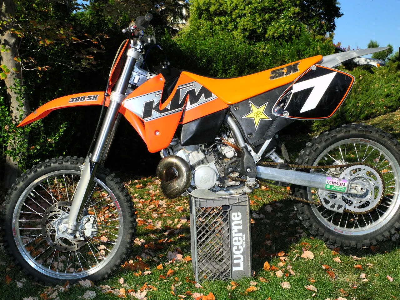

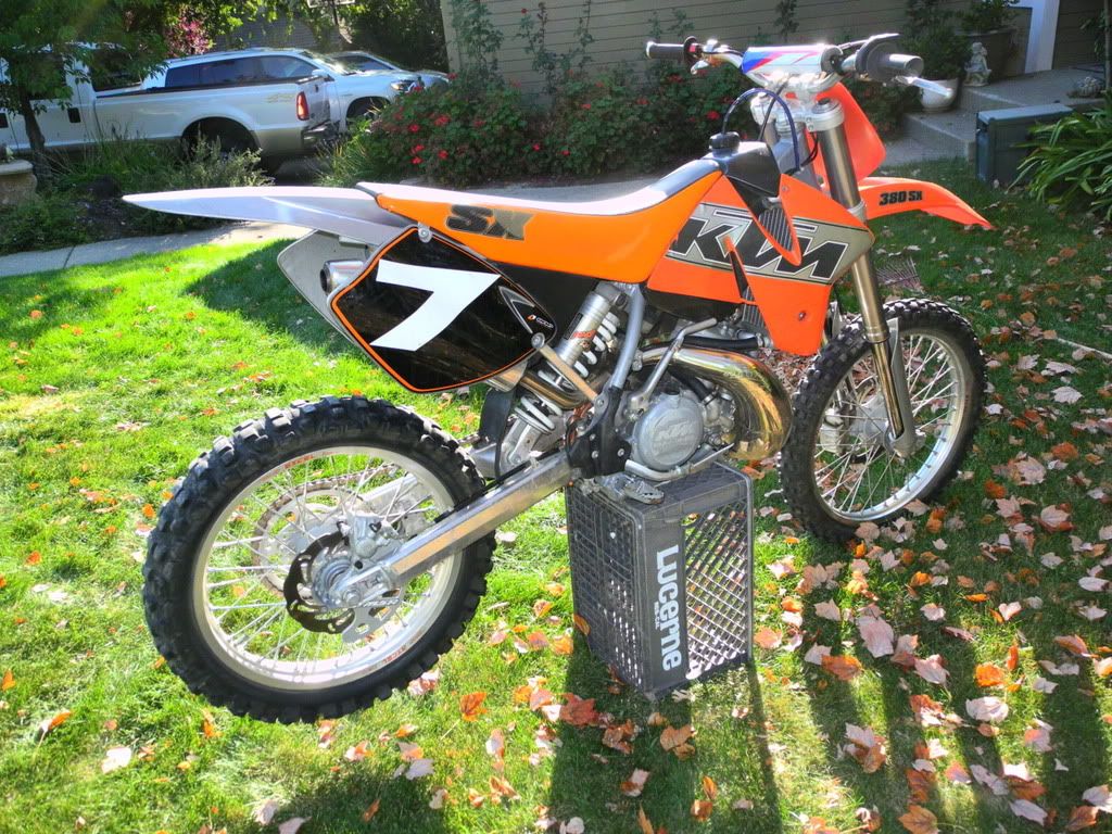

Post by: citabjockey on October 26, 2011, 01:29:37 PM
My first "modern" bike in 20 years or so. Picked this up a week ago. Starting to go through the usual stuff to make sure its ok to ride:

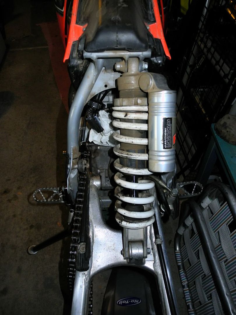

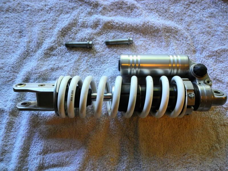

Plenty of power in this bike. I think the engine is completely stock with some sort of jet kit in it. Jetting is blubbery down low, I have a couple of pilots to try when I get it back together.  Only thing really wrong with it was one of the upper subframe bolts was missing.  :o Besides that it clearly needs a new chain, a new rear tire, and the fork seals are weeping. The rear suspension is great -- some sort of work was done by 3 Brothers Racing for the original owner (I am number 3). Bike looks like it has pretty low hours on it. Went through the shock mounts and swing arm pivot today:
Cleaned up the shock, regreased the upper heim joint. Leaving it alone:

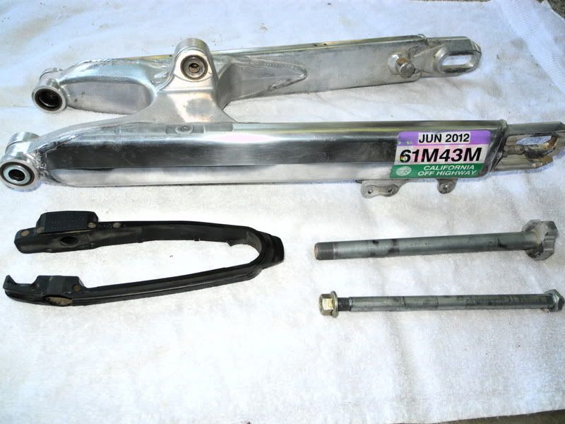

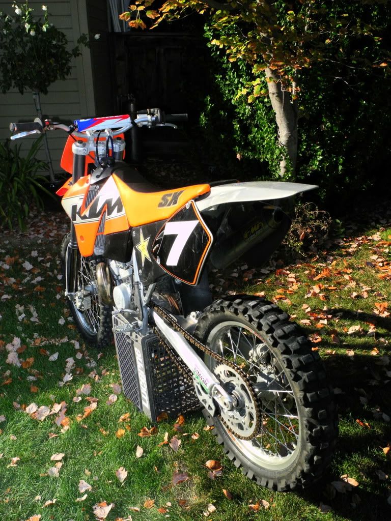

Some more cleanup.

Have a look at the lower mount for your rear shock.If there is a groove worn in it on the rear,it's from the corresponding raised section on your mudguard.Shave it off with a razorblade and it won't wear anymore.

Looks like MSR has the steel-banded spacers available. A rider in a local club posted that his KTM wheel bearings need swapping every 12 to 18 months and was wondering about this. He tried the MSR version and saw better life.
Watch your wheel spacers as they,like all ktm spacers,are made of cheese.The seal wears a groove in the spacer and dirt/water destroy your wheel bearings in short order.I had a buddy machine the part where the seal rides and press on a stainless sleeve and machine it smooth.End of problem but harder spacers are available aftermarket.
Title: New bike for me - 2000 KTM 380 SX
Post by: SachsGS on November 06, 2011, 01:21:46 AM
Bearing dealerships sell steel sleeves for repairing worn shafts - a .038 skim of the wheel spacer,press the sleeve on and you are done. ;D
Post by: citabjockey on November 06, 2011, 01:32:54 AM
Skim? is that lathe work on the spacer and then press on the sleeve? I don't have a lathe... Not sure how many other riders have one?
